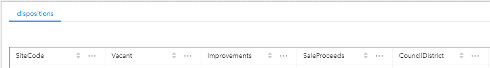

I am using the Table Widget in Experience Builder.  When configuring fields in the Widget, I can select fields for initial display to reduce the number of fields needed.  The problem is that the widget is defaulting to the Field name in the table.
Note: This is a stand alone table that is in a map service published from our ArcGIS server and has been loaded into a Web Map.  The table is not a hosted feature layer nor has it been added as an item in ArcGISOnline (beyond being in a webmap).  For the widget, I am choosing the table from the WebMap when choosing data from the widget.  I am not choosing the table directly from the map service.

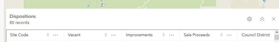

Since there doesn't appear to be a way to alter the field names in the widget, I tried changing the field name in the web map to display as I want them (ie. configure the attributes in the popup).  But the field names still show as the original in the Table in Experience.
Am I wrong in thinking that since I added the table to the widget from the WebMap data source that the field names should use what I configured in the Web Map?
Or am I going to have to go back to Pro and set the aliases on the layer in the project and republish?

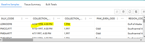

I would have thought the table would honor the pop-up attribute configurations when selecting a layer in a web map as the source, or at least would have the option to honor those settings. For example, in the picture below, the time portion of the timestamp and the comma in year would be great to get rid of in the table without having to revamp fields and republish... Especially when they are removed in the pop-up settings for the layer...

I ran into the comma issue you highlighted when I want to show install year for data. I went through the process to remove the comma (one thousand separator) through this link: https://support.esri.com/en/technical-article/000024156. This removed the comma in the web map and also shows the comma removed in a web app through Web AppBuilder. When I create a project in Experience Builder the comma is gone in the pop up windows, but when opening the data tables the comma is back. I'm hoping someone has been able to figure how to get that comma out of the table in experience builder.

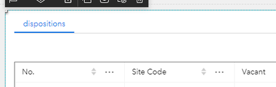

Update: changing the aliasing on the layer fields did update the Table field names. Note that I had to remove and re-add the table to see the change.

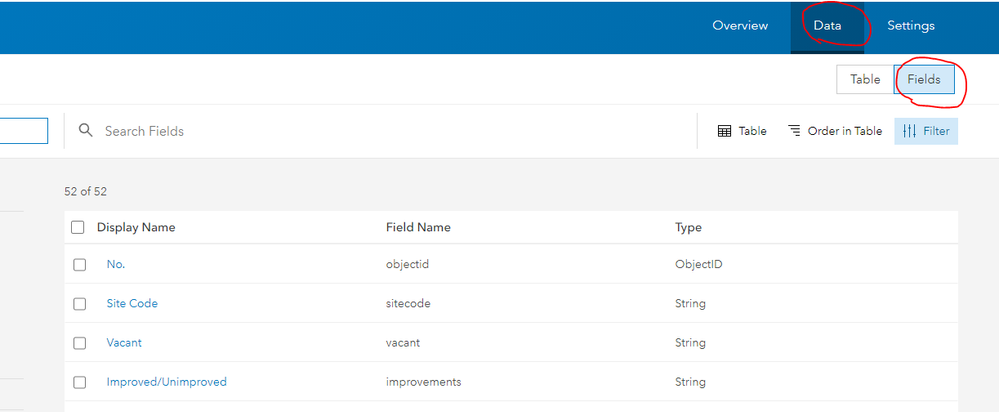

What I did was change the field name at the layer level, since it doesn't appear to honor the field name alias changes through the pop-up editor in the Map.

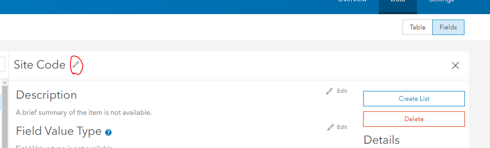

If you go into the Data tab for your hosted feature layer, then choose Fields:
You can then click on each field name to change the "Display Name"/alias
There was an update to Experience Builder in September so I'm not sure if the map settings are now honored, or if you can configure it within the widget itself now.
Hope this helps!
