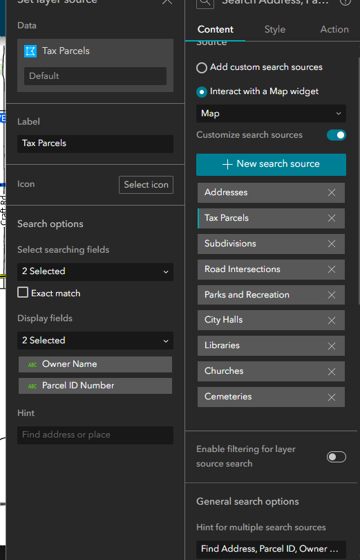

Add a search widget to your map and then add a new search source and configure it to use the field you are interested in (parcel #).

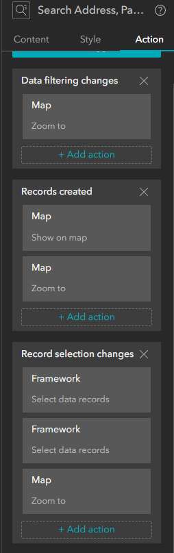

Then move over to the action tab to configure it to zoom to your results. Here is how I set mine up.
I also like to change the zoom scale from automatic.

Set your search to your liking for parcels. (Ex: Parcel ID and Owner Name)

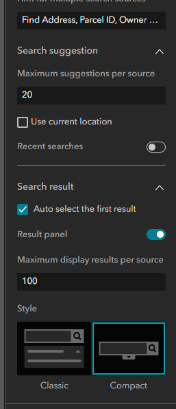

Make sure Search Result is checked for Auto Select the first result
Then check actions to make sure that you have all three actions appear
