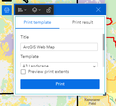

I'm trying to make an experience using widgets in a widget controller widget.
Unfortunately, widgets within the controller seem to be unable to have their sizes set, meaning that you have to manually resize them whenever you open them, or scroll down. This is kind of awful.
I was wondering if there was a way to set default sizes like you can when they're not in a widget controller?
AlfredBaldenweck_0-1684521501610.pngPrint widget inside controller
Style page of print widget inside controller
Style page of print widget outside of controller.

Hi @AlfredBaldenweck
You can try using resizable tool on the bottom left corner of the widget panel to resize, and save the app. Panel size can be remembered, but not for the position at the moment.

AlfredBaldenweck
MVP Frequent Contributor
Well, that does in fact work. Thank you.
Still weird that you can't set it from the Style page, too.
