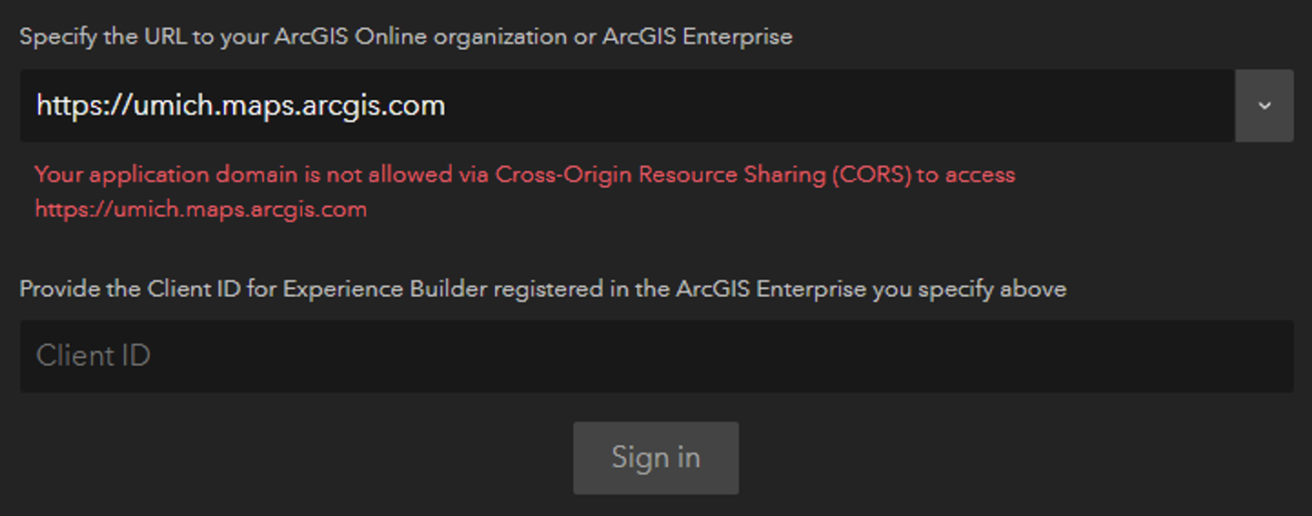

It seems that ArcGIS Online no longer permits you to use "localhost" as an Allowed Origin for CORS. So you cannot set https://localhost:3001 as an Allowed Origin, as required by Experience Builder.
The instructions in ArcGIS Experience Builder install, therefore, no longer work. When you get to Step #8 under "Create Client ID using ArcGIS Online or ArcGIS Enterprise", you cannot get past the error message, "Your application domain is not allowed via Cross-Origin Resource Sharing (CORS)..."
Instead of localhost, one has to set the fully-qualified domain name of their computer (e.g., http://mycomputer.mydomain:3001) as an Allowed Origin on your ArcGIS Online instance, and use it in place of https://localhost:3001 everywhere in the Experience Builder instructions.
Do the instructions need updating, or is there an easy way around this that I am missing?

@RobertScheitlin__GISP The problem is that ArcGIS Online now expects a domain name for Allowed Origins: "Valid servers must at minimum consist of a domain name. They may also include a protocol (http:// or https://) if you wish to target a specific protocol. Valid servers may also include the port if needed. Servers must also conform to standard naming conventions for domain names." So a Device name will not work either.

@RobertScheitlin__GISP I think you may be looking at something different than what I am referring to?
Are you referring to the specifying the application's Redirect URI, in step #6 of the documentation for Create Client ID using ArcGIS Online or ArcGIS Enterprise? There are no validation rules on that field that prevent you from using localhost or your device name.
What you register as an app's Redirect URI, however, also has to be covered by an Allowed Origin on your ArcGIS Online instance. Otherwise, you will get the CORS error I noted above, in step #8, when you start the Experience Builder server on your local machine.
It is the Allowed Origin setting that is the issue. In ArcGIS Online, under Organization --> Settings --> Security --> Allowed origins, you can no longer add a domain that is just a machine name or localhost, such as what the documentation for Experience Builder suggests using, https://localhost:3001.
