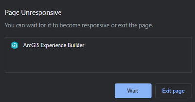

While building my application whenever I click the Near Me widget it crashes and gives me this error:
I do have about 20 layers in the near me widget. However, I was able to use these same layers (plus way more) in Web App Builder screening widget and it worked no problem.
Is there anything I can do? Or is there a better alternative to the screening widget? I want to allow a user to see what features are near a AOI of their choice.

Is this happening during configuration or when you are using it after the app is launched? This is know issue and we are working on the fix for both at the configuration and runtime side, the fixes should be released in upcoming ArcGIS Online update in February.

Both. It crashes during configuration, for example now I cant even delete the Near Me widget because the builder crashes when I click it.
Then in the launched application it just gives me a spinning wheel for where the widget should be.

I am also experiencing this issue and can confirm it has to do with the number of layers added into the widget rather than the number of records. The app goes unresponsive when configuring the Near Me widget once the 18th layer is added.
I see a bug has been logged (BUG-000163939) and a fix is in the product plan. Until then, using fewer than 18 layers should prevent the issue from happening.
