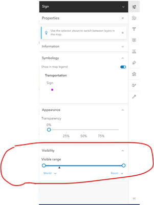

It depends on what exactly you are trying to do, but a simple solution may be setting scale dependent visibility in your webmap. For example, in this application, zooming to a single park will make additional symbology visible becoming a detailed map of the park.
You can set scale dependent visibility with the properties panel on the webmap.

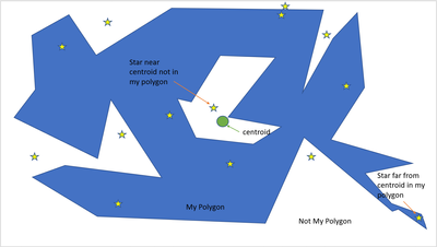

Does this picture clarify the problem? I have an irregularly shaped polygon with a hole in the middle. There is a star close to the centroid that isn't in the polygon at all and there are stars far from the centroid that are. There are seven total stars within the blue. By the current logic in Near Me, some of these stars would appear on a list of the seven closest stars to the centroid, some would be left off, and some stars that are not in the polygon would be on that list.
You could imagine the stars representing crime reports and the blue representing the city limits, if it helps. The cops need to investigate the crimes within the city, but legally can't investigate anything outside the city.

@JeffreyThompson2 I got your use case now, thanks so much for the illustration.
Now, what is your workflow at runtime? Are you searching this polygon to get the intersecting starts with 0 buffer, if you do that it should return all the intersecting stars because in that case Near Me will send the extent of the polygon and get the intersecting stars.
Another way you can accomplish your workflow, is to select the City Limit polygon to open its pop-up and from there click on the data action button and click set location. Set the crime layer as your proximity analysis layer in Near Me and use 0 buffer distance.
