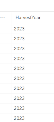

VenkataSrikanthDasari
Here is the screenshot for the Experience Builder - Table widget uses ArcGIS Portal. @SerjStol
