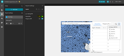

I am not sure if this setting is in the Dev Edition you have but in an out of the box Experience Builder from AGOL you can click on the Data Source on the left > Export Settings and select the cog wheel for the layer you want and untick the formats then in the table you will see the export options selected

 Unfortunately, the layer is added dynamically via the Add Data widget (the layers are not PRE-added to the webmap), and the setting isn’t available 😞
