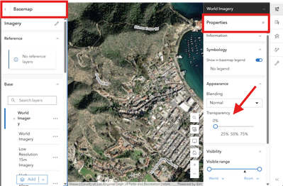

You can set transparency on the basemap in Map Viewer and that will carry through to other apps like Experience Builder.
In Map Viewer, drill into the basemap and use the Transparency slider in the Properties pane, then save the map and open in Experience Builder.
