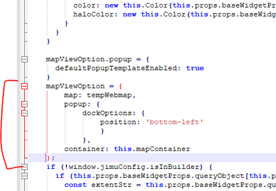

Hi David, I'm trying to follow along with your suggestion but running into issues viewing the new widget in the ExB. I copied the map widget and pasted it into client/your-extensions/widgets, added code sample above:
changed the name of the widget in the manifest.json to Map2, and then attempted to run the compiler as described in step 5 of this documentation. However, I get an error in the command prompt:

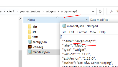

JeffreyThompson2
MVP Frequent Contributor
Make sure that the name in manifest.json matches the name of the folder it's in.

I was able to modify my copy of the 'arcgis-map' widget to dock the popup by default by updating the 'onJimuMapViewCreated' function in v1.13. To change the location of the docked popup update the "position" attribute.
onJimuMapViewCreated = (jimuMapView: JimuMapView) => {
    jimuMapView.setMapWidgetState(this.props.state)
    this.setShowPopupUponSelectionForJimuMapView(jimuMapView)
    // START CUSTOM CODE
    console.log('onJimuMapViewCreated function loaded')
    if (jimuMapView.view && jimuMapView.view.popup) {
      // Modify the popup property to dock the popup by default
      jimuMapView.view.popup.dockEnabled = true;
      jimuMapView.view.popup.dockOptions = {
        breakpoint: false,
        position: "top-right"
    } else {
      console.error('MapView or Popup is not initialized');
    // END CUSTOM CODE
ZachBodenner
MVP Regular Contributor
Kinda like this?
That doesn't seem to have made a difference.

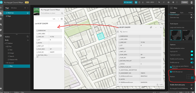

Jianxia
Configuring where to dock the pop up from 6 positions is planned for the upcoming June release of ArcGIS Online.
Bryan_krg
The ability to dock the popup is great. It's now under Map -> Content configuration. But what would also be good is the ability to add the popup to a sidebar like in the picture below. (and stop the popup displaying). The Feature Info window is close put not the same.
Jianxia
@Bryan_krg , could you please elaborate a bit more on Feature Info not working in the way you want in a side panel?
ZachBodenner
I'd like to agree with @Bryan_krg on this one: the feature info widget is not the same, primarily in how it reads Arcade. I spoke with some of the ExB Team at the UC this year about it (still haven't gotten back to me) and they said they would investigate and probably log a bug. It would be nice to have even more auto-docking options, but this is a good feature added, thank you @Jianxia !
