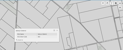

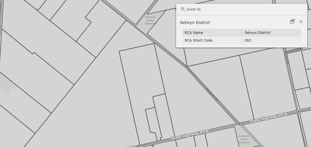

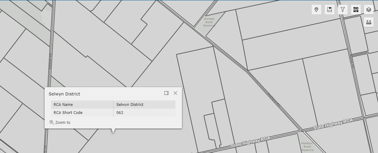

Is it possible to change the default location for docked popups in experience builder?  The experience I am building defaults to the top-right of the screen which obstructs other tools.
Undocked:
Docked:
