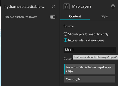

In the latest AGOL February release, the Map Layers widget has supported a new feature - "Customize layers":
This will help fulfill this specific case.

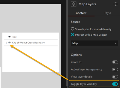

@sroberts_uuF21 In ExB, you could try the following steps inside the Map Layers widget:

Thank you for the response @TonghuiMing !
Unfortunately this does not solve our problem. The above suggested solution allows users to be able to turn the layer on and off in the app. We dont want users to even be able to see the layer in the map layers widget as an option. In WebAppBuilder there is an option to hide layers from the layer list widget but this does not seem like an option in Experience Builder.
