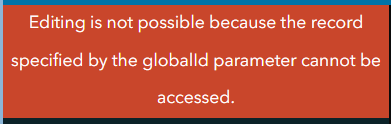

Hi All,
I have created an experience using the survey widget. The user selects a record from the list widget which opens the existing survey record to edit.
This works fine for users with admin roles however returns an error for Creator Data Editors.
I have followed trouble shooting here but am still unable to resolve. Has anyone else come across this issue?

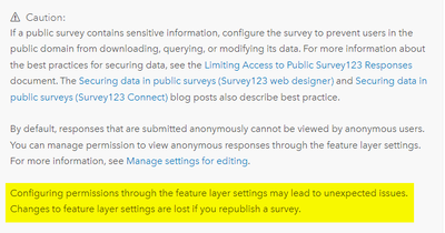

No idea what the issue was but i suspect it may have had something to do with configuring permissions through the survey feature layer and re-publishing the survey a number of times which caused unexpected behavior. Noted here
Happy to say the issue is resolved!

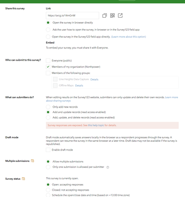

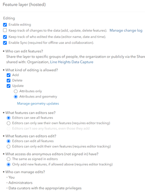

Thank you for your reply, i can confirm Creator Data Editors see the error message for all survey records. I am using the hosted feature layer (not a view - Do i need to be using a view?) and the settings are as in the screen shot below -
The Survey was published from the Survey123 website, share settings are as follows -

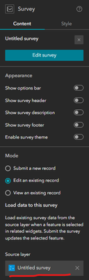

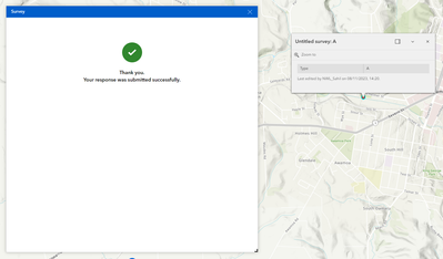

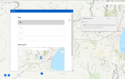

I tried publishing a survey and using the widget within a ExB app. It seems to work for me.
I think the issue might be in setting the up the survey123 Widget in ExB.

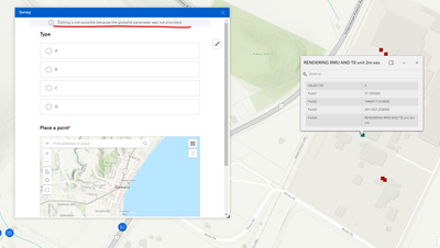

Could you confirm if that mode is set to - "Edit an existing record" and the source layer is set to the survey123 layer?
In my example I have 2 datasources on the map.
When I select the one that is not the survey layer then I get the error suggesting GlobalID was not provided.
When I select a feature from the survey123 layer I can successfully edit the feature.
If that's not it then you could try checking that the survey123 layer created has a GlobalID field in it. I don't see why it wouldn't but worth checking.
