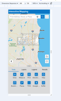

Moving over to a mobile view, we can see the tools are totally rearranged, which just will not happen without custom re-arranging for a mobile size:
In this case they've also repositioned the map tools and put the search right at the top. Resizing the window now does not "smush" the search bar, which tells us here that they might have hard-coded the distance from the sides of the parent container in some way.

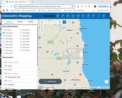

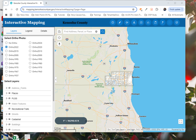

for reference I'm trying to achieve something simple and clean like they have in this app here - https://mapping.kenoshacountywi.gov/InteractiveMapping/
ZachBodenner
MVP Regular Contributor
Sure that's helpful to see. Yeah so for this one, you can tell that the search widget is positioned as a percent value away from the left side of it's parent container. This is discernable if you un-maximize the window and then click and drag a corner. You'll see how the search widget eventually goes behind the map tools if you drag it small enough.
I would recommend using a hard-coded pixel value to set its distance from the left side because then this wont happen to matter the size of the window. It will also create a consistent look across all window sizes. What I like to do is find the size of the map tool button and then add 10px or so on each side, and use that value as the left-distance px amount. So if the home button there is 50 px, then I'd set the left-alignment of the search widget to 70 px. Also don't put it in a widget controller, just let it float.
