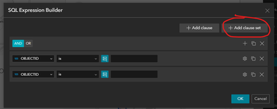

You can go into the SQL Expression Builder and use the Add Clause Set option to create filters like: A is Y AND B is N AND C is N AND D is N.
The problem with this is that if a user selects A and B, they will get no results as it is impossible for B to be both Y and N.
