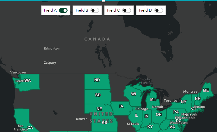

I am having difficulties figuring out how to filter. I have a Web Map with one layer on it with 4 fields with domains Y or N. I want to be able to toggle on the data based on FieldA = Y. If only one filter is on I want it to show data for FieldA=Y and the rest of the fields being N. Right now, the map is filtering only for Field A=Y but the other Fields are both Y or N.

You can go into the SQL Expression Builder and use the Add Clause Set option to create filters like: A is Y AND B is N AND C is N AND D is N.
The problem with this is that if a user selects A and B, they will get no results as it is impossible for B to be both Y and N.

Is there a way to set the toggle as N if it is off?
