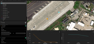

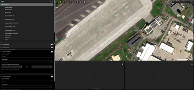

In my web map, I have visible by default in the map one copy of this layer with the default filter of "list_index = 0" to display the single parent point for each location, and I have multiple copies of this layer that I use to add a halo underneath/around the parent points and to populate the charts when the user selects a location ID. The copies of the layer have the default filter of "list_index = -1" to ensure that these points don't show up on the map and that the charts are empty until after a user specifies a location ID. Default view when loading the app:
View after selecting location IDs and other parameter for the copy layers:

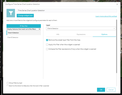

This is possible in Web AppBuilder because of the "Remove the preset layer filter from the map" option in the Filter widget:

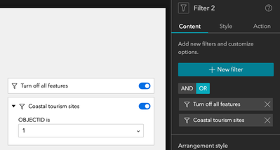

Hi @MattChomicky1 - I could think of a simple solution, but the usage level might be limited depending on your SQL complexity.
The first option is that you can configure a filter widget with clauses like the following - one clause with a solid none case, like ("OBJECTID=-1"), and not ask for values; then add other clauses that ask for values (they must not contain preset values, being all empty to make it work). Remember to set the logic operator to "OR":
Last but not least, you need to turn on the option "Apply this filter automatically". In this way, you will have the following behavior which starts with none on the map and filter by the desired/input values:
(view in My Videos)
The second is pretty much the same but could be a little more straightforward - add a single filter item to do the above configurations, with only that special clause & turned on automatically. In other filter items, add the criteria for your cases. You can use OR/AND depending on how you want your users to experience:
Hope it could be helpful somehow for your app.
