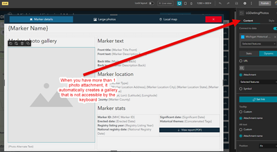

I am wondering if there are keyboard controls for the image carousel in Experience Builder that gets used when there are multiple image attachments connected to a record?  It would be a worthwhile component to include in a future release to meet some ADA requirements if it is not already incorporated.

Hi @JeffreySchmidt3000 - to be specific, is it the feature pop-up attachment, or feature info widget, or inside the image widget that you are talking about?
JeffreySchmidt3000

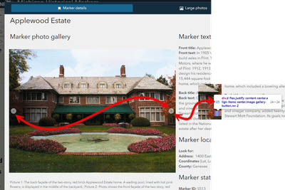

Hi @TonghuiMing Let me send along some screenshots.  It is part of the image widget.  I cannot get focus on the image buttons on the left/right of the image container, it simply skips past them both.   Here is an example public experience.  https://experience.arcgis.com/experience/0810844003f149faa1a3aeaa64d7d42e

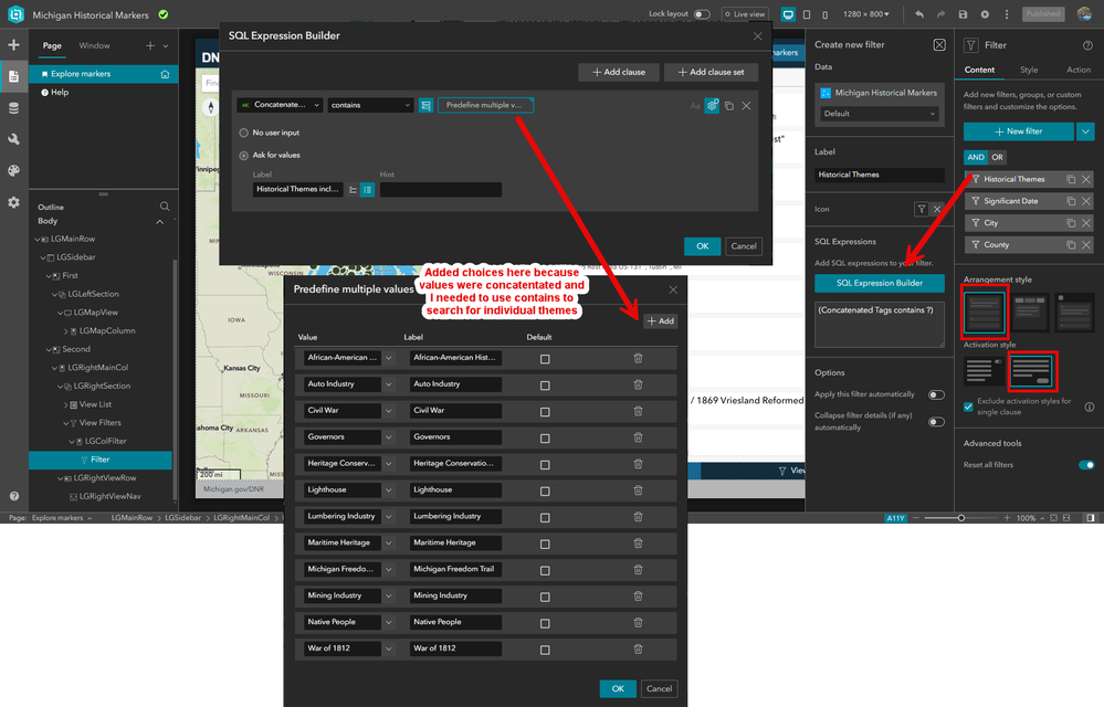

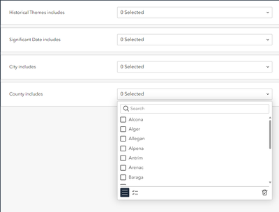

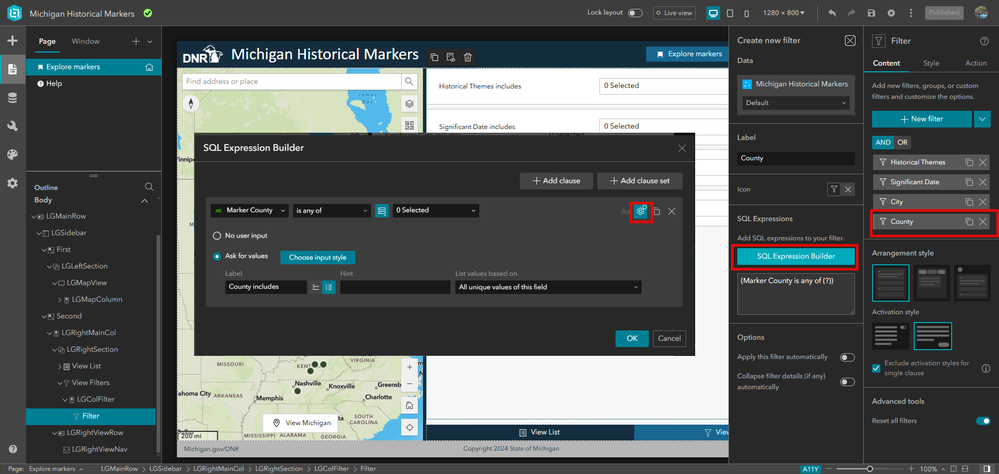

The experience in the link (https://experience.arcgis.com/experience/0810844003f149faa1a3aeaa64d7d42e) of you answer has a filter section with a widget behavior that I don't how it was created.
Do you have any info regarding how that filter functionality was created, type of widget and configuration?
Regards.
JeffreySchmidt3000
Thank you for reaching out.  It is the stock AGOL filter widget and to make use of the check box/multi select, I have them set up like the screen shots below.  I used "contains predefined multiple values" in one filter and "is any of" in another to give options to the user.
