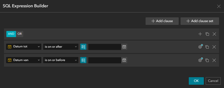

It seems an easy filter but could not get it. I want the user only enter 1 date to filter records and see what restriction there are on a chosen location.
I have a hosted feature layer and each record has the attributes  [restrictions], [activity], [date_from] and [date_till] ] that I want use to filter. [date_from] and [date_till] is a given period that defines the restrictions for that record.
I created this filter:

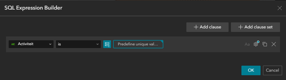

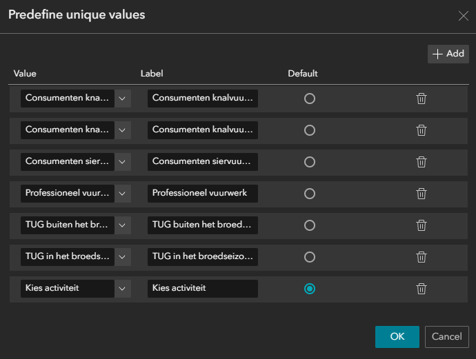

2. defined the activities as predefined and an extra value as default to start with an empty map for this layer
3. asking for a date. Now need to ask the date of the activity twice to filter the records in the layer.

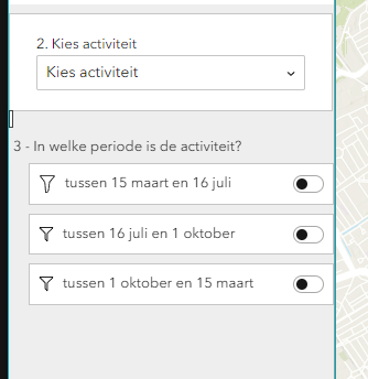

I have changed my approach, even I am still curious if there is a solution (or only a customized widget could do the trick)
Because the date of the activity is in a certain period, I created 3 filters and ask the user to say in which period the activity will take place and filter the records based on 2. and 3.

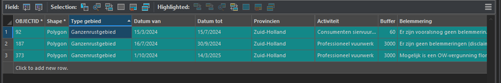

I want to ask the user a date and use that as input to select certain record(s) . I only want the record(s) were the given date is in date_from <= given date <= date_till
below screenshot of 3 of 573 records in the table. i.e. I want to select the record (objectid 92) where the activity is 'Consumenten siervuur...' on April 16.

I see. Thanks for the screenshots. For this scenario, I think the group filter cannot deliver either, since there are two separate operators (one is on or before, the other is on or after). A custom widget might be a better solution.
