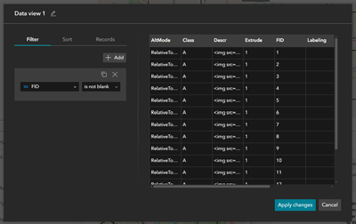

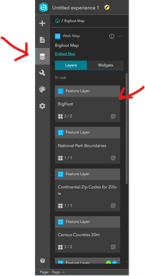

You can achieve this with Data Views. Find your data in the Left Side Panel, then click Create A View.
Use a filter that doesn't actually filter anything like FID Is Not Blank.
Set your Table Widget to show data from this View and the Action to also filter the View. The Action should only filter the data in the Table now.
