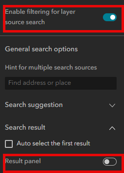

If you use a layer search source, you can configure the search widget as below:
Then the List widget, which uses the same data, will display a filtered result after the search.

Hello this still doesnt work for me I already had these parameters but my list wont filter based on what I search in the search widget
