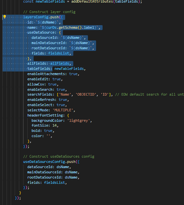

Edward_Wong
this should give u some insight on how to customize ur table (or sheet to be specific) at runtime or limits column. Hopefully that helps
Edward_Wong_0-1739495765731.pngEdward_Wong_0-1739495765731.pngEdward_Wong_1-1739495770017.pngEdward_Wong_1-1739495770017.png
