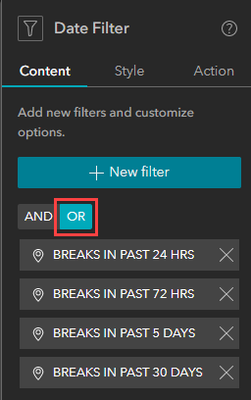

I'm using the #Experience Builder Dashboard template and am attempting to replicate functionality in an existing legacy Operations Dashboard. Here are my questions:
1. I have a filter with several options to filter data by DATE. How do I set this filter to only allow a single selection?

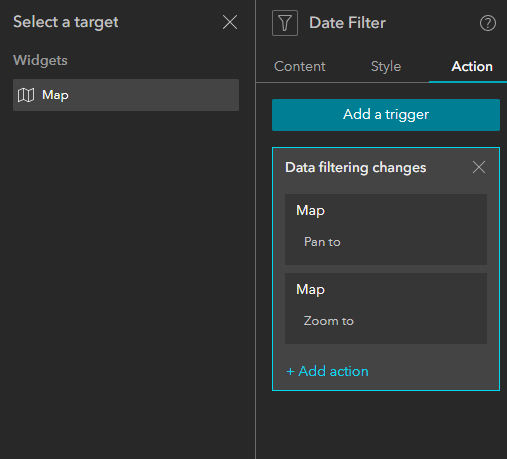

2. I have a second filter allowing the user to further refine the data by STATUS. How do I configure an action or trigger on the first filter to restrict the choices in this second filter to only be relevant to the selection set? The first filter only appears to allow actions against the map, not other widgets...

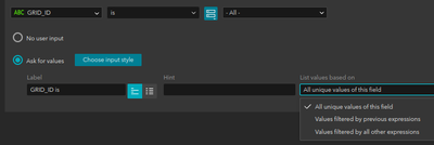

Second item: this is possible, but it's a bit more hidden. When you configure an individual filter in your widget, you'll see it here:
This requires that all the filters are part of the same widget, however.

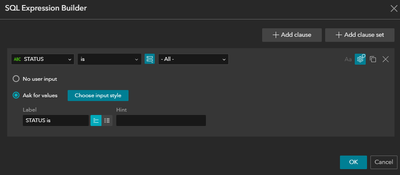

Thanks @jcarlson but I can't replicate what you show above in your screenshot. My STATUS field is derived from a domain so I'm confused why...

TonghuiMing
The options @jcarlson provided in the screenshot earlier are for unique values. I assume your domain field is set as User Input - that's the difference. You can change the input source to Unique Values and you will see the options.
