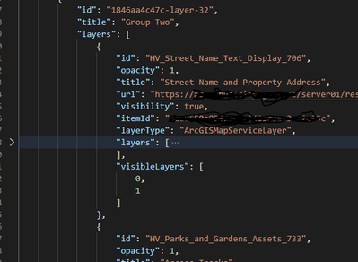

HI @Curt_H it looks like it does. If you use something like ArcGIS Assistant   to view the webmap JSON you should see that the Group Layer is assigned an id and well as all the sub layers.
That Id is then used within Experience Builder along with the id of the layer.
So when you move your layer out of one group and into another, you are effectively giving it a new id.

Experience Builder is data source driven, and when you add a layer to a widget as data source, the layerId of the layer in the webmap JSON is used as the reference, not the URL. As a result, if you remove a layer that is being referenced, then add it back in again, it will get a new layerId within the map. As a result the data source breaks.
If you need to update a data source, the best way to do it is to use something like ArcGIS Assistant to update just the URL of the service, and maintain the layerId.
