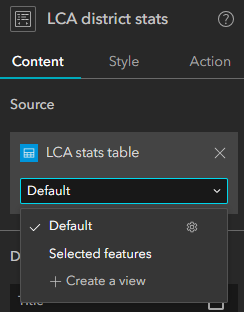

The widget configuration:

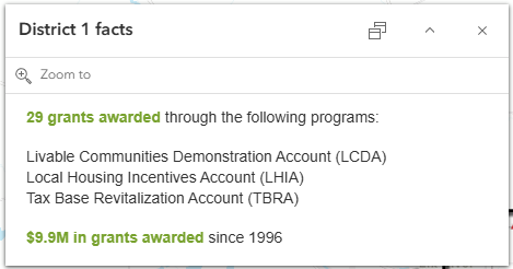

The functioning popup in Map Viewer:

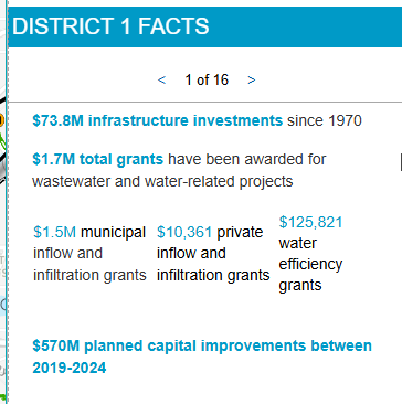

Similarly configured widget working in a different view (comes from the same hosted table in a different web map):
