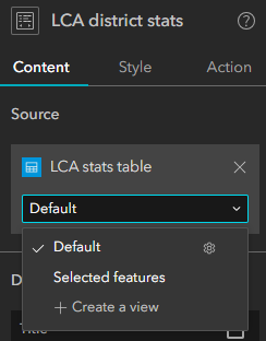

  • In the widget configuration, data source is configured for "default", not "selected features"

The widget configuration:

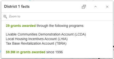

The functioning popup in Map Viewer:
Similarly configured widget working in a different view (comes from the same hosted table in a different web map):

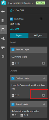

To find the layer id:
In the data tab, click on the map.
Then click the ID button on the layer.
I don't think group layers would change anything. You could test with them outside of the group to be sure, but from the Arcade docs, I think by id would be a better option and easier to match a single digit than a string.
HannahWilson3
Hi @EMani - are those screenshots from AGOL or maybe ExpB Dev Edition? I'm using Exp Builder in Enterprise 11.3 and do not see the ID.
