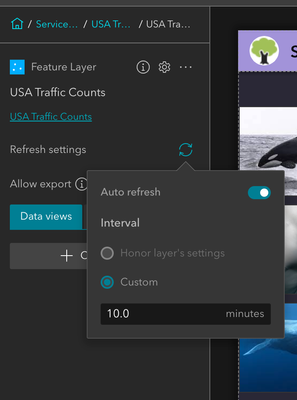

DanJiang
Could you please try open the auto refresh option in the data source settings to see if this solves the problem?
