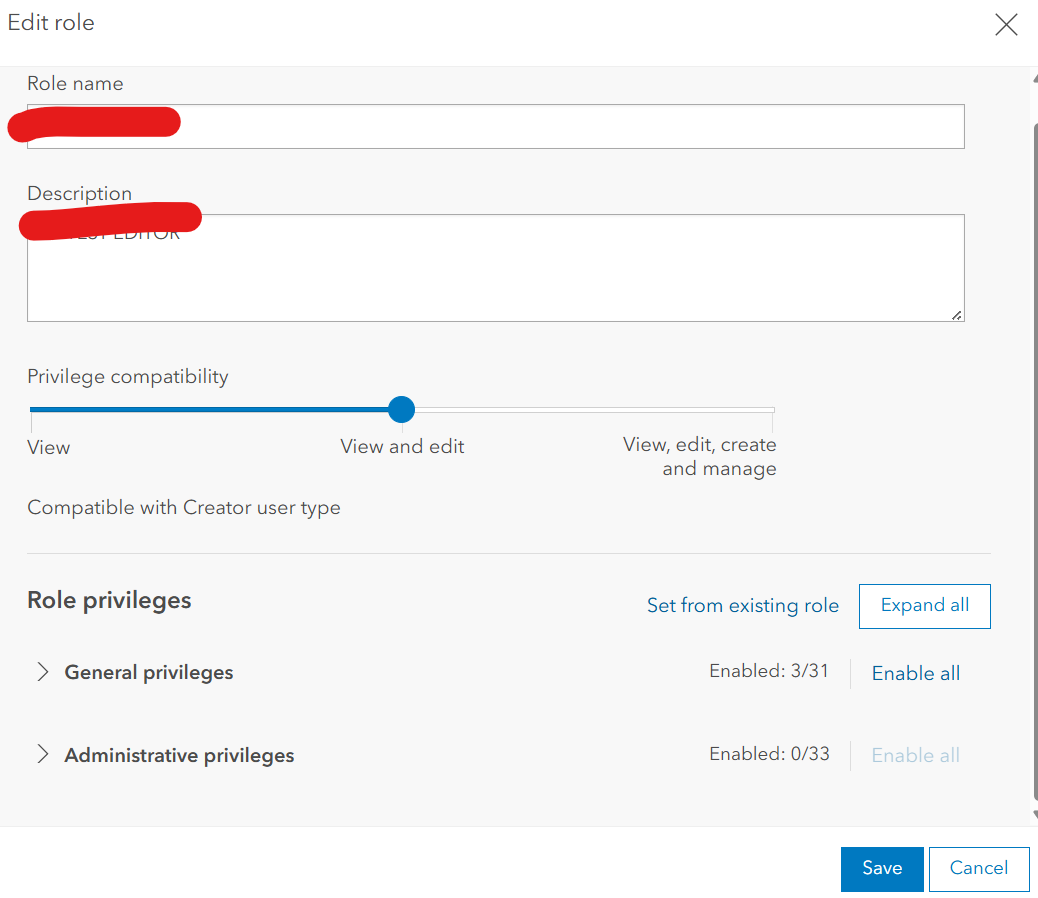

From 11.5 Enterprise's version, I encountered problems with the export button (e.g., export to csv) within ExB widgets (Select, Table, etc.). In detail, using ExB app, web map and web services (e.g., map image layer) with a member that is not the owner, the export button on ExB only appear if particular Member rules are configured. I tried two different member with different Member rules, one without "Administrative privileges" flags, and another with some “Administrative privileges" flagged. Member with "Administrative privileges" has the button to download data on ExB, while member without "Administrative privileges" not! When at least one "Administrative privileges" of Member rule is flagged, export button appear on ExB widget, otherwise no button appear. Furthermore, the export button always appear for member who owns the ExB, web map and map image service. Attached configuration of Member Rules and export button behavior on ExB widget.

Here my question: is this behavior normal? is there the possibility to enable the export button for member without "Administrative privileges" in Member rules? It is quite strange, because only Creator user type can use the export button on ExB.
