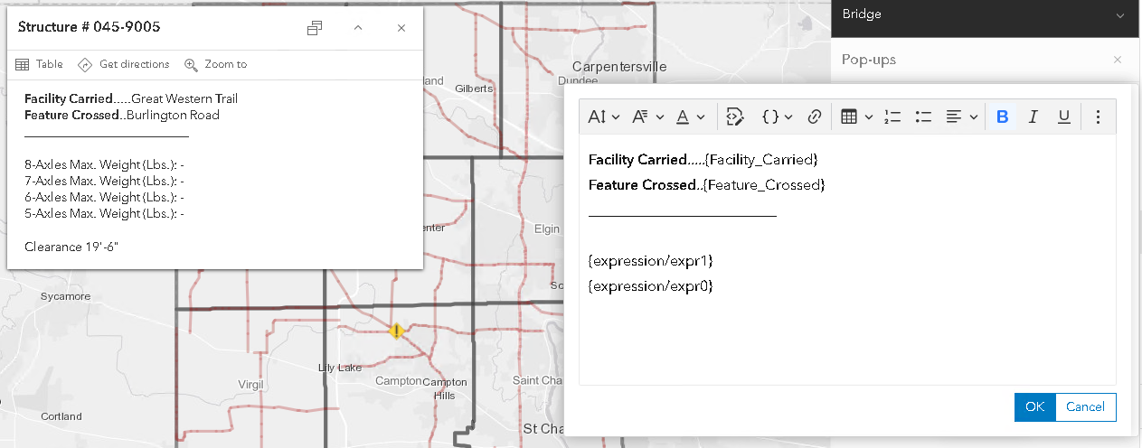

For example, we have a layer that formats the display of attributes using the Text card.

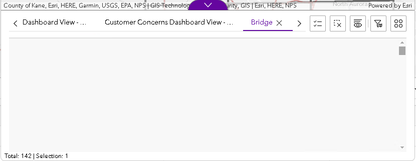

In the app, the table is empty but the record count is correct.

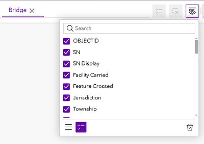

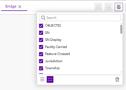

It's possible to view the data if you use the Show/Hide Columns button but it's quirky - You have to click the "Show Selection" tab and then unselect and reselect each column you want to view. If you close the table or resize the app you have to turn on all of the fields again.
We also have a couple of layers that are configured to use the Title card but not show any fields. We get the same empty table behavior.
I see why it makes sense for the table widget to honor the visibility of the fields set in the popup but what is the work around for when you want the popups to be customized and the table to be useable?
