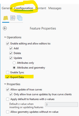

TravisSlack
For the record, using a feature service also did not work for me as per the recommendation without using the export flag during publish. I had to republish the feature service with the "Export data" flag which was not required prior to upgrading server to 11.5
