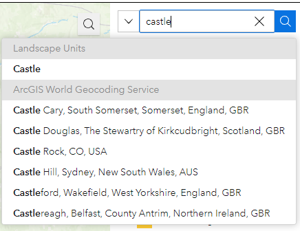

For context, I am reading both my own hosted layer, "Landscape Units", and the ArcGIS World Geocoding service. I have set it so that the Landscape Units should appear at the top of the drop-down:

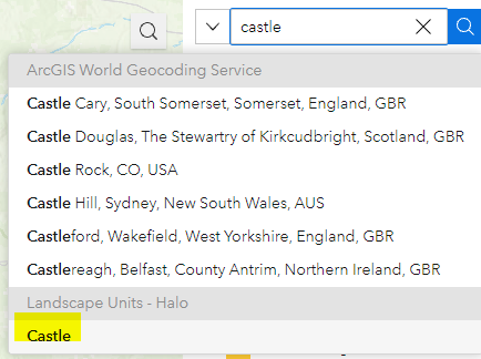

Initially, when using the search bar, the drop-down does not respect this ordering:
(Landscape Units are at the bottom)
Selecting "Castle" will filter the associated layer, but will not select it. After clicking the selection, a second drop-down appears, this time respecting the set ordering:
When "Castle" is clicked in this drop down, the associated feature is selected, and actions related to that selection are carried out.

UPDATE 2021/09/17
The order of the search items is now being respected, thank you! However, I am still getting two drop-downs. I have also added images to show the map behaviour - note that I am running the search widget on a white layer that underlies the black boundary lines as a workaround for the filtering issue I mentioned
Initial view of map, with "halo" effect:
First search, 'Castle' selected:
Map filters layer, but does not select (note that the "halo" effect is only around 'Castle' now):
Now, the second drop-down only shows 'Castle', but I still need to click it in order for the selection and related actions to occur:

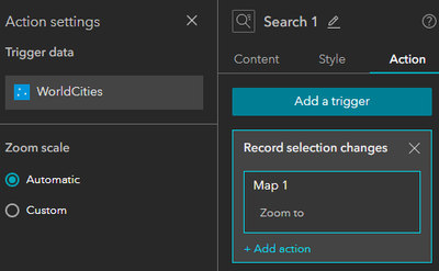

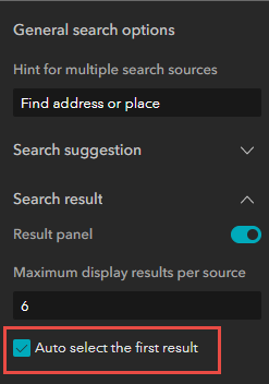

For your update, if you want to make something similar to the Search widget in WAB, you can try the below settings:
This is what it looks like at runtime:
(view in My Videos)
Shengdi
