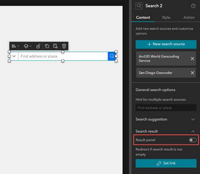

So far, I am not a fan of the second dropdown.  I found it pretty confusing, but perhaps in some instances it could be very useful.
I would very helpful for users to have a way to close the second dropdown.  The only way the user can get it out of the way is to click the "X" in the search input.  From my initial work using a locator with the Search widget in the Developer Edition, clicking the "X" appears to destroy the output dataset that contains the address and geometry information.  This can be demonstrated when using the output from the Search widget to perform and spatial query in the Query widget.  After clicking the "X" in the Search Widget, the Query widget updates saying, "0 records are selected for the filter."

ShengdiZhang
1.
If you don't want to use the second dropdown - the result panel, you can disable it from the widget settings:

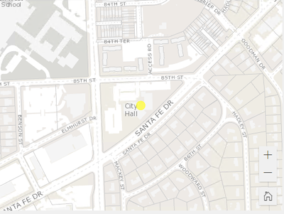

They felt pretty strongly that when using a locator a graphic should appear on the map to show where the address is.
If you want to show the locator results on the map, you can set a Records created action:

I would now add that the only things that I expect to be asked about are:
1.  Can we change the color and other properties of the graphic that shows the address on the map?
2.  For zooming in, can we set a custom scale?
