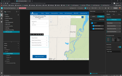

Ok thanks @TianWen  I see.  Ok.  This is the desired work flow:
Using the Search widget,  the user queries a parcel polygon via a Parcel ID from a feature layer source.
The returned record should be visible as an Output source for the Query tool, where that geometry is then used a a spatial filter for another layer, like Zoning:
As you can see, the Parcel Layer does not show up as an available output source.  The 2 output sources that do appear are both Locator output sources.

TianWen
I see the problem! Actually, Search widget will generate output data source only when it consumes geocode services. So it is as expected.
To achieve your intended goal, you can add the original Parcel layer as a filter layer in the Query. Then use a Filter widget configured with the same data. Apply filter conditions in the Filter widget, then the returned geometries are the candidates that can be used to conduct a spatial filter (select them all in your case).

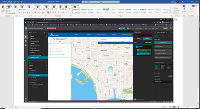

DavidColey
MVP Frequent Contributor
Hi @TianWen  - I gave this a try and the output from the Filter Widget is not showing as an active or available Output Source for the Query Widget:
Am I missing something?
