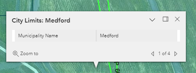

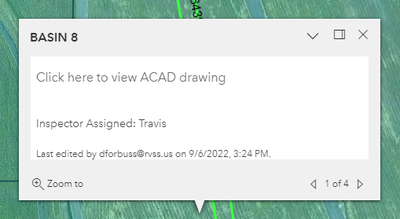

I'm having this same issue.  When zoomed in, I want a particular layer to be the first one to show in the popup, and the other's to still be available in the list if you click the right arrow.  As of now, it seems to be almost random which layer pops up first.  The only option I've had was to adjust layer visibility by zoom level, but then my users have had to get used to zooming out to be able to interact with the other layers' popups.  It seems they could add a "pop-up" widget to experience builder to solve this.  I'd actually really like it even more if I could combine popups some how so they all show up in one window.
First click:
Second click in same spot:
