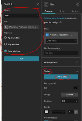

Setting a list's link under "States" to an attribute in a data file isn't working.  All the other attributes in the data file are working fine.
I've got the link set to an attribute which contains urls.  Clicking on the first card in the list goes to the correct URL (good), but clicking on ANY of the cards in the list also goes to the first one's URL (bad!).  In other words, I've got a list of 4 cards, and they all click through to the same page.  Yes, I've verified that I have different URLs for each card in my data file (see attached).

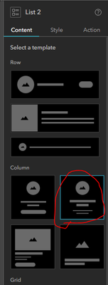

1) I choose the following template (any template or without template will work as well)

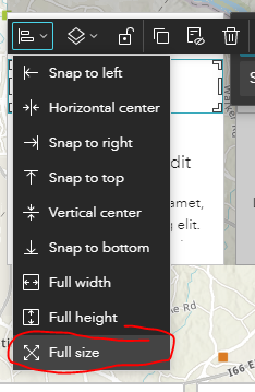

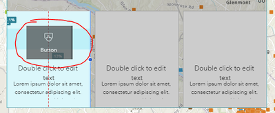

2) After selecting the datasource, add a button on top of the list (it might be difficult to add the button, just find a empty space or can delete all elements on the list, then add button first before adding other elements).
3) Set the button as full size and sent to the back.

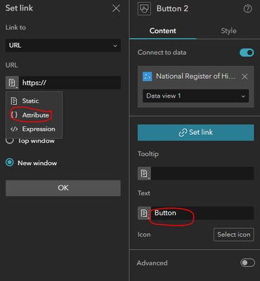

4) Set the link of the button to the attribute URL. Remove the text from the button.
5) After save, I can get all the item in the list to open the link based on the features.
* Points to note : Do not set the link under States config.

Thank you, Ramani!  That's a good work-around that I didn't try.  Maybe the States URL isn't supposed to work the way I expect it to.
