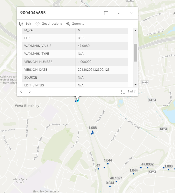

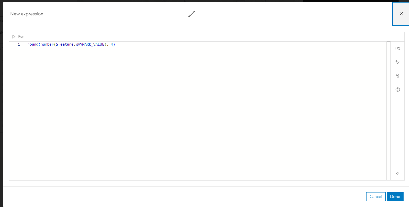

Morning,
I am fairly new to Experience Builder and writing label expressions in Experience builder which I believe uses JavaScript/Arcade?
I have a field called "WAYMARK_VALUE" which has been rounded to 4 decimal places in the 'Fields' list and it also shows correctly in the pop up box shown below. When applying the labels it seem to have a mixture of decimal places, from zero places and to the correct 4 places, so i am a bit puzzled why this is not working?
I have copied a piece of script I found online which i thought would work, but unfortunately it doesn't seem to consistently work, so any help would be much appreciated.
Once i have the rounding issue sorted, i would then like to add multiple attributes to my label expression, ideally the "ELR" attribute and the "WAYMARK_VALUE" rounded to 4 decimal places. (ie;  BLT1 - 47.0880

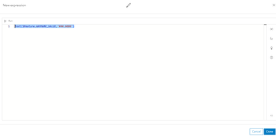

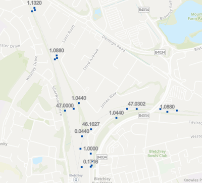

StephenDuncan
Afternoon Issy,
Thank you for getting back to me on this and supplying the links to the information. I have played around with the Text function and it seems to have worked in ArcGIS Online Experience builder on the labels 🙂
This was the script that seems to work for me:
Text($feature.WAYMARK_VALUE,'###.0000')
Hopefully you are also able to get it to work for you!
Appreciate your help,
Many thanks,
Steve
