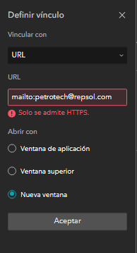

I'm trying to link a text to an email address using mailto:[email protected], but it gives me an error. The message that only HTTPS is supported appears. My Enterprise version is 10.9.1. Does anyone know what could be causing this? Thank you!

Mailto function was added since AGOL 2022 Q3 (portal 11.1), while portal 10.9.1 is quite a few releases back - AGOL 2021 Q1.

You are very right. Thank you so much!
