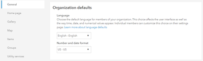

The default units in Experience Builder are set by your organization admin in the ArcGIS Online/Enterprise environment.
My guess is that since you are logged in when using Chrome it is pulling from your organization defaults, but when you look at the Experience without being logged in, it is pulling the default units from your computer.

Yes, it does seem to be pulling from org defaults when we are logged in. I checked all of my settings on all three browsers and my computer settings, everything is set to US, but is still flips to km. I want it to always pull from the setting I set in experience builder because this is a public app and most users won't have a login and I can't communicate with them to change a browser setting (although I haven't found one they could change that would solve this). I opened a case with Esri. I will post if they have a resolution to this.
