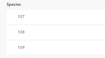

On first use, the edit widgets (some of which are configured to edit related tables) display numbers instead of the correct strings.

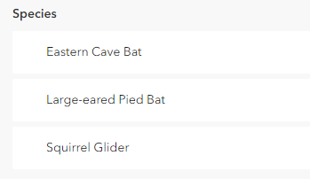

After selecting one of the numbers and then going back, (some of) the strings are displayed correctly.

When I start the app and select a record from the Query tool, the Edit widget shows numbers for each record instead of the record names. When I click on one of the records for the first time, only the record name (e.g., Eastern Cave Bat) loads in the form, and no other records contain any data.
When I go back to the list of records for the related tables, I can see the record names listed. If I click on one of these records a second time, all appropriate data loads in the form.
