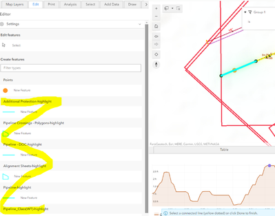

Hello @TianWen @Jianxia - I have been doing further testsing on this matter within ArcGIS Online and the problem still arises where I have an Experience with:
  • An Edit Widget
  • A Map Widget
  • An Elevation Profile Widget - with settings 'Selectable Layers' Enabled with either the 'Ground Elevation' OR 'Customize' settings applied for the Selectable layers.
Within the Published Experience the problem arises when:
  1. A user opens the Elevation Profile Widget
  2. Uses the Select Line method
  3. Selects the Line in the Map
  4. The elevation profile then draws using the select line
  5. The selected lines then appear in the Edit list under 'create features' - as can be seen below:PatOBrien_0-1722551444259.png
    Therefore the bug is still present in ArcGIS Online, so I suspect that even if we upgrade to Enterprise 11.3 (currently on 11.2) it will also be present.
    Can you please investigate and inform if:
    1. It will be fixed in ArcGIS Online
    2. It will be fixed in Enterprise 11.4
    Thanks

I am experiencing this issue in the current version of ArcGIS Online when using map services in a web map. After a feature is clicked in the Map widget in Experience Builder, an entry appears in the Edit widget named <LayerName>-highlight. Will this issue be fixed in the near future? Thank you.
