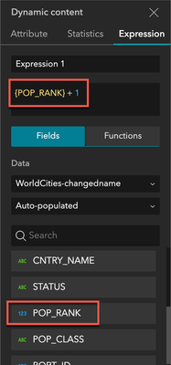

Hi @PatrickHanley1 ,
You can try using an Expression in the Text widget to add dynamic content.
