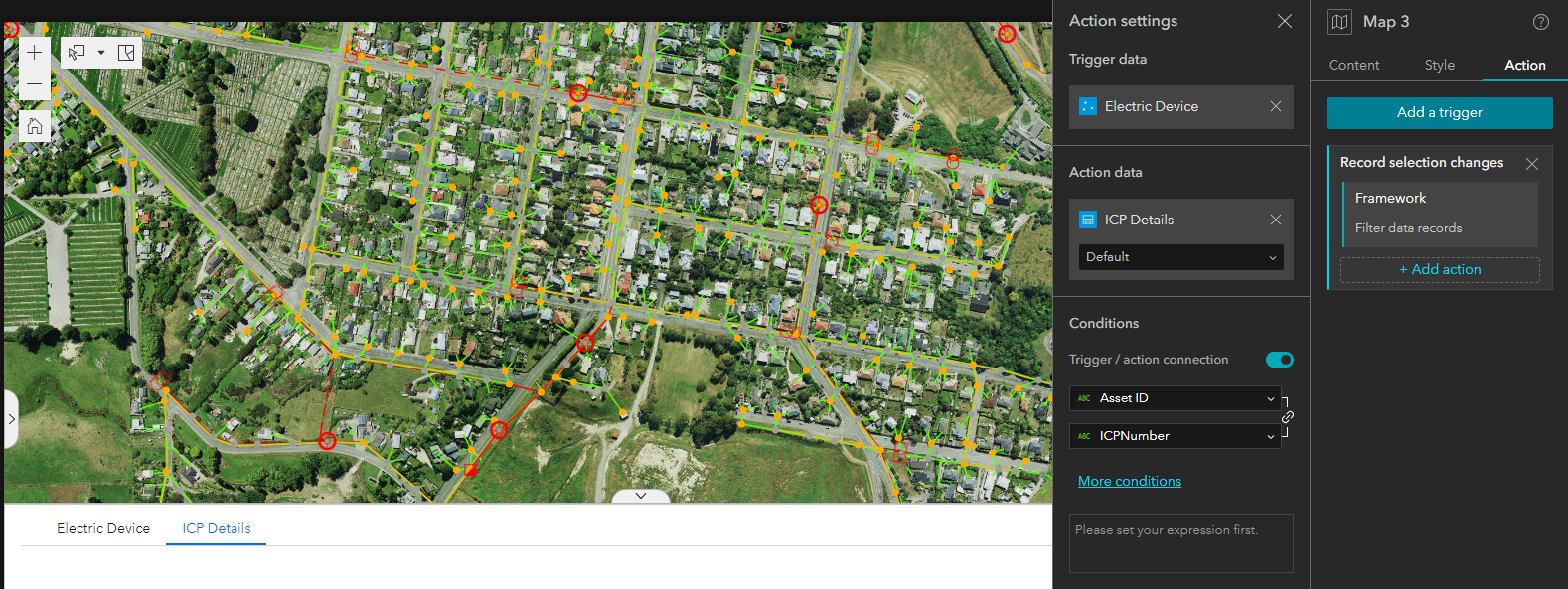

I have set up the data action in Map

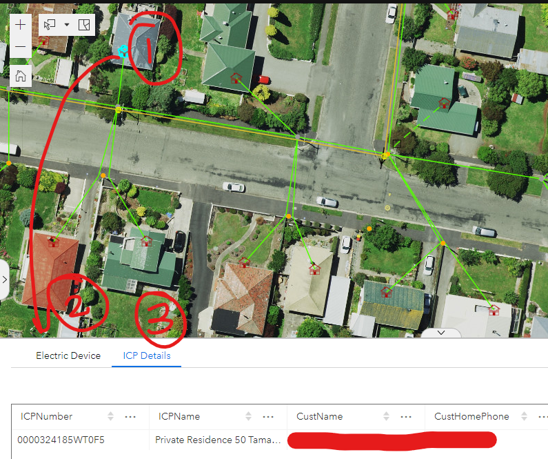

And this works when I select a record manually.

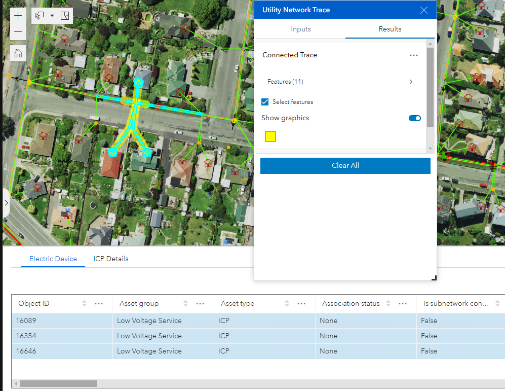

This DOES NOT work when I run the trace UN Trace widget
It selects the records in the feature layer but nothing in the standalone table.

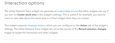

I also see the new Utility Network widget has a data-action tab maybe it will be possible then.
https://doc.arcgis.com/en/experience-builder/latest/configure-widgets/utility-network-trace-widget.h...
