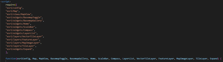

JohnDoroba
You have to add "Expand" to require and function, then create an element/widget object in your script.  Then you have to create an expand object  that calls the element/object you want to expand. Here's an example from a JS API script I wrote for a webapp:
Here's an example from ESRI
https://developers.arcgis.com/javascript/latest/sample-code/widgets-expand/
