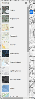

I am working with ArcGIS Experience Builder Developer Edition to build an application. How I understand the docs and how it is described here (@DavidMartinez), the basemap gallery shown in the application should be the one from the organisation (ArcGIS Enterprise).
However, this does not seem to work for me. Even though I have a basemap gallery defined in my Portal for ArcGIS (which works in the Portal), my application shows a different list (ESRI basemaps). This is the list I get:
Any idea what I am doing wrong? Do I lack some configuration somewhere? The connection between the application and my Portal seems to be fine, as I draw all my data and a Geocoding service from it successfully.
