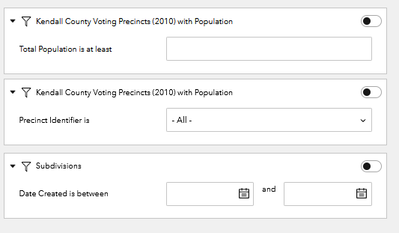

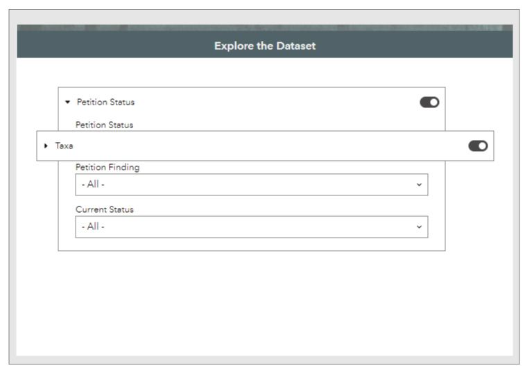

The need: create several filters for a table and group filter by topic.
The approach: create several individual filters within a column, keep the first filter open and set each of the other filter to "collapse filter details"
The problem: filters layout don't react to other filter widgets when one is opened (see pic)
Are there is any way to accomplish this?
Thanks,
JB

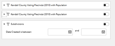

How are your filters being arranged? I can have multiple filters in a single Column container with their heights set to Auto, and this seems to work just fine.
ExpandedExpanded
CollapsedCollapsed

JoseBarrios1
I figured it out! My problem was that the "Height" on the size settings for each filter need to be set to "Auto"
JB
