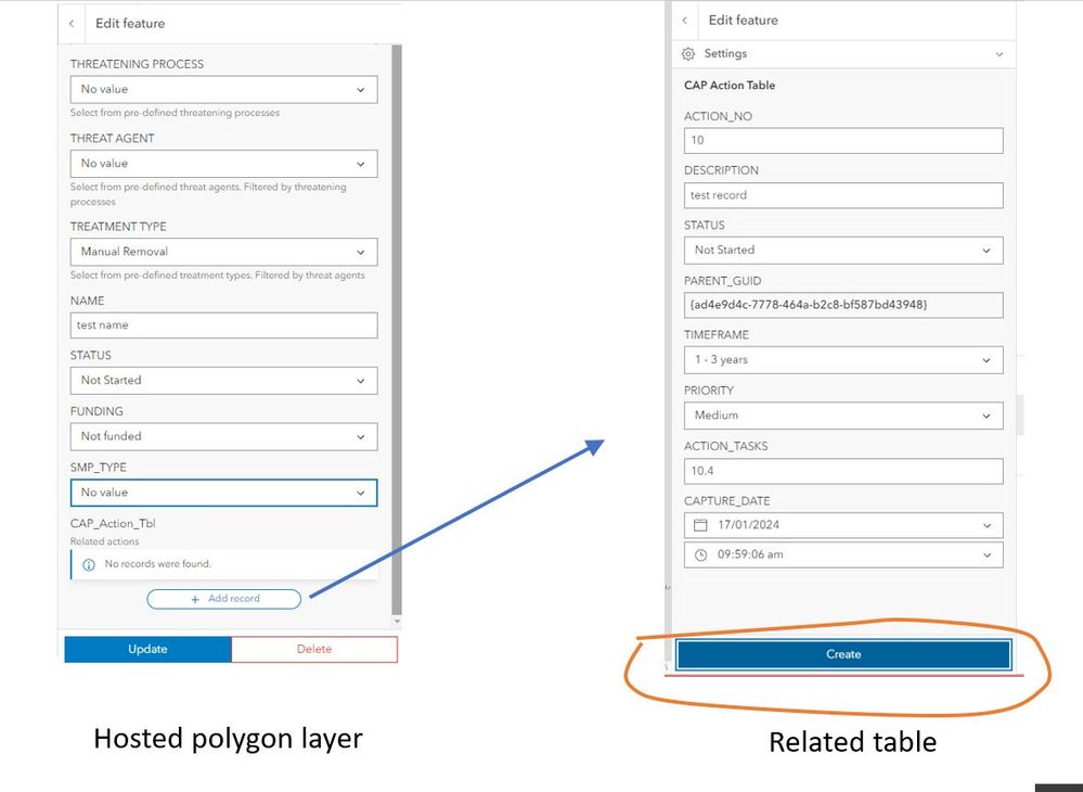

I have set up a 1 to many relationship between a polygon layer and an "Action" table and are utilising smart forms in the new Web Map to allow users to add new polygons and related actions in the table.
The layers are hosted in ArcGIS Enterprise 11.2 and have been published through Pro. Geometry and table editing is enabled. This web map is also added to a  very simple ExB project, but the behaviour (and error) I'm describing below is the same
My workflow is a follows:
- In the Web Map (or ExB), select the polygon layer and open the edit tool
- digitize a new polygon, complete the field attribution and save this record
- Select the polygon again, which reopens the smart form and now there's the option to add a related record
- The edit form for the related record opens fine, the parent GUID is carried over and I can edit attributes
- When I select "create" , the button flashes but nothing happens and the record is not committed. There's no way to move on form this step other than backing out and discarding the edit
I can add related records in Pro after this data is published so I'm thinking that the data structure and relationships are sound. I don't have any of these fields set to mandatory.

Hi @ChrisH2 , if you try doing the exact same editing steps directly within Map Viewer using the Edit widget there, are you observing the same issue?

Yes @AlixVezina it’s the same behaviour in the map viewer
