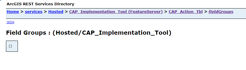

The development team has discovered the source of the problem. Ultimately, it is because the standalone related table is configured to have contingent values, but it does not actually have any display fields or continent values within it. The API "thinks" it should have it in there since the metadata says it does, but in reality they're empty.
This can happen if field groups are defined but no contingent values are defined before publishing the feature service.
For this reason, an error occurs and the related records cannot be created. The team is planning to resolve this issue for an upcoming update and the changes will become available in 11.3.
To fix this issue in 11.2, we would recommend to try republishing the feature service without the field groups or contingent values. If you were planning to use contingent values, perhaps try configuring them again and republishing.
