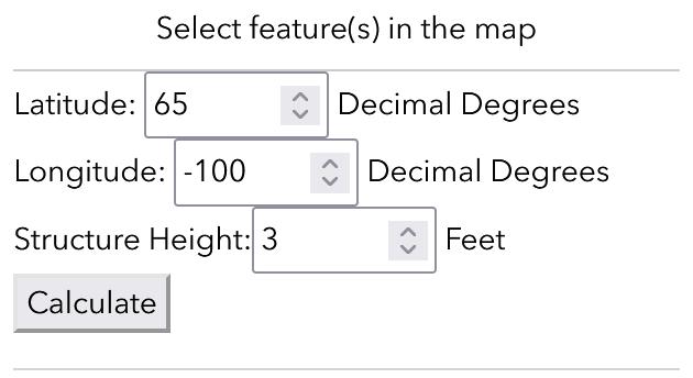

Here's my lat/long/height boxes and calculate button. This code is in the render section. They all show up and exist. You can use the arrow buttons or enter numbers and those change the values in the boxes.
            Latitude: <input type="number" id="LatTextBox" defaultValue="34.7" style={this.latlongboxStyles} onChange={this.updateInputLat} value={this.state.latTextBoxvalue}/> Decimal Degrees
            Longitude: <input type="number" id="LongTextBox" defaultValue="-86.9" style={this.latlongboxStyles} onChange={this.updateInputLong}/> Decimal Degrees
            <br></br>
            <div className="StructureHeightDiv">
              Structure Height:
              <input type="number" id="StructureHeightTextBox" defaultValue="0" style={this.latlongboxStyles} onChange={this.updateInputStructHeight}/> Feet
            </div>
            <div className="CalculateButtnDiv">
              <button className="CalculateButton" type="button" onClick={this.handleCalculateButton}>Calculate</button>
            </div>

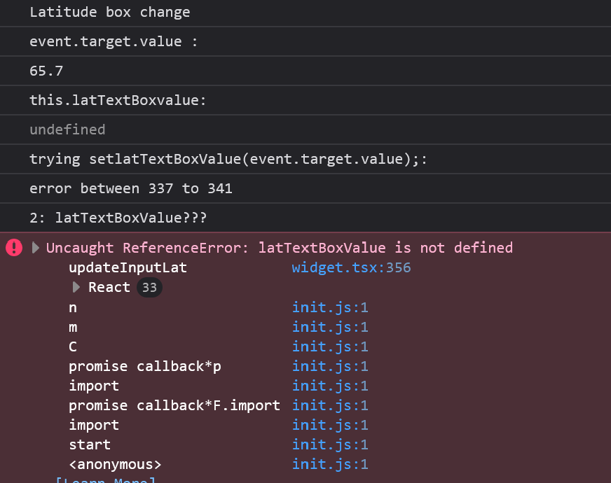

and my updateInputLat listener passes the event value succesfully
 updateInputLat=(event)=>{
    console.log("event.target.value : ");
    console.log(event.target.value  || "undefined"); //this does get the right value.
But I cannot figure out how to pass that value to a variable that I can access outside of updateInputLat

So in short, I have no idea how to define a global variable to pass around the... classes? functions? what are they even called? And I cant find any esri documentation on this. Eveyrthing I find for react doesnt work. I've tried declaring these variables all over the place and just cant figure it out.

Check your casing in the this.setState function, the render method is using,
while the setState function is using latTextBoxValue with a capital V.
 this.setState({latTextBoxValue: event.target.value})
Sometimes these issue are frustratingly hard to see, especially when you've been staring at them for too long.

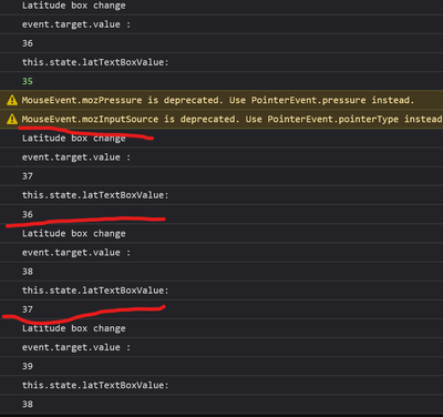

    try{console.log("this.state.latTextBoxValue: ")
      console.log(this.state.latTextBoxValue)  //succeeds but is 1 off from event.target value???
    catch{console.log("line 325 failed")} //this is not erroring out?
 but now, despite all the values working as variables... the values arent syncing up between event.target value and this.state.latTextBoxValue
Each red line in the screenshot below represents the console changes when clicking on the Latitude box's up arrows. Any ideas why latTextBoxValue is 1 off from event.target.value?

Re the next issue, setState is an asynchronus operation, so its likely the state has not updated before you try and log the result, you could try:
this.setState({latTextBoxValue: event.target.value},() =>{console.log("Updated state:" + this.state.latTextBoxValue)})
I wrote the above in the browser... I think I got the brackets in the right places. See if that works.

State is not live data it is a stored unchanging value at the last re-render and setState does not update state until the next re-render. You should use setState to store values into the next render and do any other processing off of event.target.value directly.
