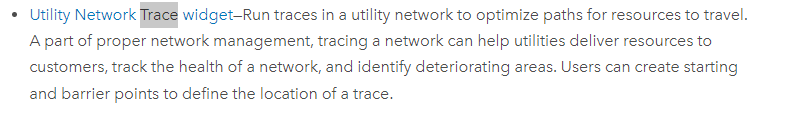

@DrewDowling  @VanessaSimps  - Looking at the website, it suggests the trace is available only for Utility Networks. All the examples I have seen it being used in were Utility Networks.
https://doc.arcgis.com/en/experience-builder/latest/configure-widgets/widgets-overview.htm

@gis_KIWI4Thanks for pointing that out. Since many of the trace operation REST endpoint parameters are common between the 2 I was hoping ESRI made them compatible.
Unfortunately, it looks like I'll have to code my own.
