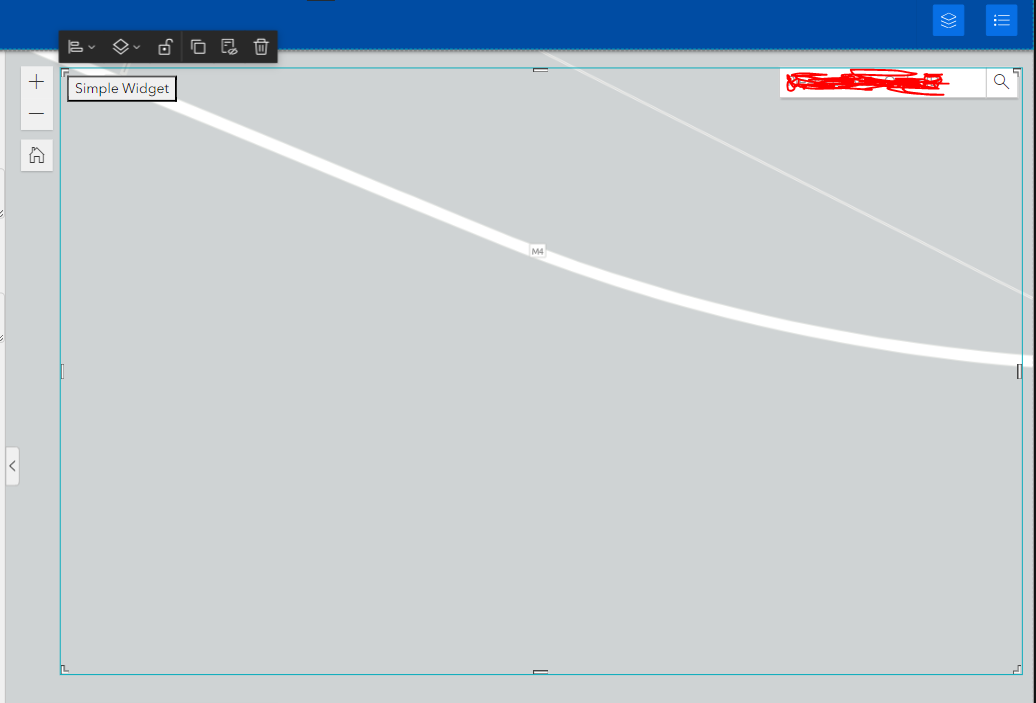

I have a custom widget that I need to be overlaid over the entire Map View widget. Let's say the widget will have a button in the corner that needs to respond to clicks. At the same time, I don't want the background of the widget (everything except that button) to register any clicks or mouse events so I can still interact with Map View.
Is it possible to achieve this?
Basic example would look something like this:
